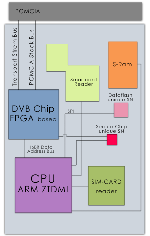

    D-Module description:
    Based on Duolabs technology D-Module is a fully programmable PCMCIA module dedicated to DVB compliant STB-CI applications known as CAM (Conditional Access Module). D-Module is designed to give maximum flexibility and power for developers all combined with high security features to enhance the possibility to host a secure CAS.
    The first Open Source Conditional Access Module. Why?
    In an era where all manufactures are closing their technology Duolabs belives in an open source project which can offer a low cost implementation for small Broadcasters who cannot affort big R&D costs.
    The today's Conditional Access colution companies are asking high entry costs to get access to their technology subscribing long term agreements with warranty on their system's security.
    This is the reason why we belive an open source project may help individuals and small companies to experiment on the field their solutions supported by a senior members crew who may help to speed up the development.
    Some parts of the CAM are not open source and supplied only in binary format to void third parties copyright violation.
    Why D-Module?
    D-Module is uniquely designed, as product that differs from others in that it allows you the fully customize your design thanks to the flexible structure of the internal FPGA. All the known CAM modules in the market are based on an ASIC design in order to reduce the costs of each single device but sensibly reducing the customizable features and disclosing sensitive information about the eventual CAS and its structure and disclosing security information.
    Architecture:
    Hardware:
    •ARM7TDMI @ 50Mhz.
    •FPGA @ 100Mhz processing speed.
    •RAM: Internal 16KB and External 512KB.
    •ROM: 256KB Internal Flash and 2MB Dataflash.
    •J-tag connection.2 Smartcard Readers ISO and Plug-In.
    •2 Unique serial Numbers internally lasered inside.
    Software:
    •PICO-OS Operating System.
    •Dataflash internal Filesystem FAT 12.
    •Fully programmable by PCMCIA secure protocol.
