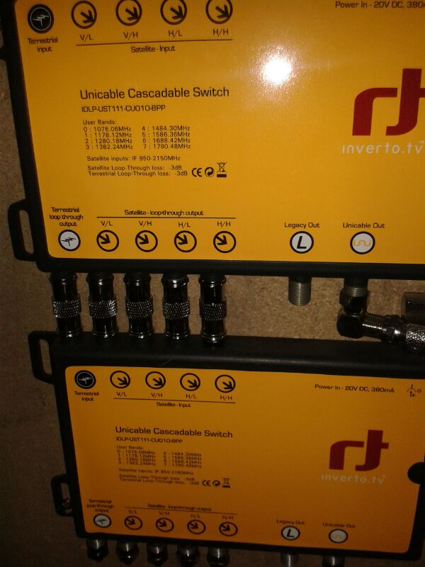

    Multischalter:
    Hersteller Type
    Ankaro UCS 51440, UCS 51820, UCS 51840,
    UCS 52240, UCS 52420, UCS 52440
    UCS 91440, UCS 91820, UCS 91840
    UCS 92240, UCS 92420, UCS 92440
    DCT Delta SUM518, SUM918, SUM928
    Dura-Sat UCP18
    VDU543NT
    VDU563NT
    VDU583NT
    VDU586NT
    VDU983NT
    G-STAR GS-506-S1
    GS-516-S
    JULTEC JPS0501-6
    JPS0502-3
    JPS0502-6
    JPS0504-3
    Inverto IDLP-UST11O-CUO1O-8PP
    Kathrein EXR501, EXR551, EXR552
    ROTEK EKL2/1, EKL2/1E
    Smart DPA51
    Technisat TechniRouter 5/1x8 G, TechniRouter 5/1x8 K,
    TechniRouter 9/1x8 G, TechniRouter 9/1x8 K
    TechniRouter 5/2x4 G, TechniRouter 5/2x4 K
    TechniRouter 9/2x4 G, TechniRouter 9/2x4 K
    Telstar SCR 5/1x8 G, SCR 5/1x8 K,
    SCR 9/1x4 G, SCR 9/1x4 K
    SCR 5/2x4 G, SCR 5/2x4 K
    SCR 9/2x4 G, SCR 9/2x4 K
    Wisi DY 68 1810
    DY 64 2410

    WISI:
    ID1: 1178 MHz
    ID2: 1280 MHz
    ID3: 1382 MHz
    ID4: 1484 MHz
    ID5: 1586 MHz
    ID6: 1688 MHz
    ID7: 1790 MHz
    ID8: 1892 MHz
